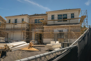

Is the secret to housing affordability in California buried in the building code?​
by Ben Christopher May 15, 2025
New homes under construction in Pleasanton on June 16, 2024. The city of Pleasanton has voted to explore the possibility of becoming a charter city.
Photo by Loren Elliott for CalMatters
As lawmakers scramble to turbocharge post-fire recovery efforts in Los Angeles and to tackle a housing shortage across the state, a new addition may be coming to California’s building code: A pause button.
Assembly Bill 306 would freeze the building standards — the rules governing the architecture, the layout, the electrical wiring, the plumbing, the energy use and the fire and earthquake safety features — for all new housing through at least 2031. Local governments, which often tack on their own requirements, would also be kept from doing so in most cases.
Building standards tend to reflect the state’s most pressing concerns. New seismic requirements are added after major earthquakes, home-hardening requirements have followed deadly fires and new green energy mandates have popped up as California has raced to prepare for a warmer planet.
This latest proposed change to the code is meant to tackle another crisis: affordability.
