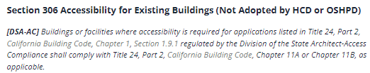

I'm working on a few interior TI projects where the means of egress is causing me and some of the designers here to butt heads. I and others on my team have different interpretation on two seemingly contradictory sections of code related to accessible means of egress. Can anyone provide their interpretation of these sections of code?
CBC 1009.1: ... Accessible spaces shall be provided with not less than one accessible means of egress. Where more than one means of egress is required by Section 1006.2 or 1006.3 from any accessible space, each accessible portion of the space shall be served by accessible means of egress in at least the same number as required by Sections 1006.2 or 1006.3. In addition to the requirements of this chapter, means of egress, which provide access to, or egress from, buildings for persons with disabilities, shall also comply with the requirements of Chapter 11A or 11B as applicable.
CBC 11B-207.1:
Means of egress shall comply with Chapter 10, Section 1009 and Section 11B-207.
Exceptions:
3. Accessible means of egress are not required to be provided in existing buildings.
My question is, assuming my understanding of these two sections is correct, which section takes priority? 1009.1 clearly states that an accessible means of egress is required to some degree, but 11B-207.1 has an exception for existing buildings. Both sections are adopted by DSA-AC, which makes me think I'm missing something obvious or just really overthinking this.

The only issue is CEBC / IEBC isn't adopted by DSA-AC. DSA-AC is the authority over public and commercial accessibility in CA and a commercial TI project falls under their scope, so since the CEBC isn't adopted by that agency (and there are multiple references in CEBC that simply state that CBC 11A or 11B should be followed over the CEBC), that section means nothing.
At least, that's how it's been described to me by someone who works at the Division of the State Architect (they just told me to ignore CEBC for accessibility).
