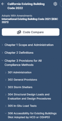

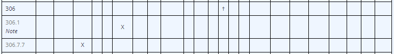

The California Conundrum (per the title of this thread) - IEBC 306.7.2 was not adopted in the CEBC in California:

And from your post 2 I agree that that don't need to be added......But when you choose to add egress then you have to make it accessible in the non-discriminatory sense....And I would go with the "general" of 306.7.2 does not trump the "new is new " of 804.1....
The commentary of 306.7.2 speaks about upgrading existing elements not being feasible in existing buildings which I get, but my opinion is if it is new then.....
