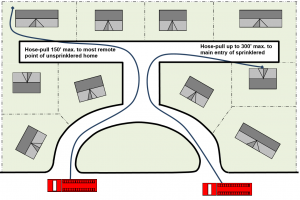

I want to understand how distance to the farthest structure from a fire access road is measured for code purpose. For a residential addition, new sprinklers may or may not be needed based on this.
The home after remodel is less than 3600 sq feet. It is a remodel. The 'existing' structure which is not being remodeled is the farthest from the street, on a corner. Should that be taken into consideration? Are decks part of the 'structure' too for fire access distance?
So for a rectangular plot, is it safe to say the width of the plot (minus the side offset) plus longest length of the building plus distance from the center of the farthest portion of the building towards the street to the middle of the street is what the distance should be? Is there any guidance on how this measurement be made?

Normal for fire lane/access road is measured from the city/ public street
As the hose lays/ fire truck drives
To within where the fire truck parks and the last 150 feet as the hose stretches to reach all parts/ farthest parts of the building.

Approved fire apparatus access roads shall be provided for every facility, building or portion of a building hereafter constructed or moved into or within the jurisdiction. The fire apparatus access road shall comply with the requirements of this section and shall extend to within 150 feet (45 720 mm) of all portions of the facility and all portions of the exterior walls of the first story of the building as measured by an approved route around the exterior of the building or facility.

However, the FD says sprinklers will be needed if the farthest structure from the access road is over 200'.
"Fire Apparatus Access Roads Required for Buildings and Facilities: Approved fire apparatus access roads shall be provided for every facility, building or portion of a building hereafter constructed or moved into or with the jurisdiction. The fire apparatus access road shall comply with the requirements of this section and shall extend to within 200 feet (as amended by SCCFD) of all portions of the facility and all portions of the exterior walls of the first story of the building as measured by an approved route around the exterior of the building or facility. [CFC, Section 503.1.1]"
This is a normal tract home with a 60' wide street and the lot itself is 149' deep! The structure is well within 200' from the center of the street The farthest corner is about 91' from the street -- if you draw a straight line from the center of the street through the 8' side yard to the back corner. If you loop many times to bring in a fire hose you can come close to 200' (If you lay the hose as a C to get to the corner instead of going straight) but that should not be what plan checkers doing. There must be a standard definition to measure this distance and that is what I am looking for.

Sometimes if there is a question, the submitter submits a site plan, showing scaled distances.
Once again it is as the fire truck drives, plus normally the last 150 is stretching the hose, on the exterior of the building.
