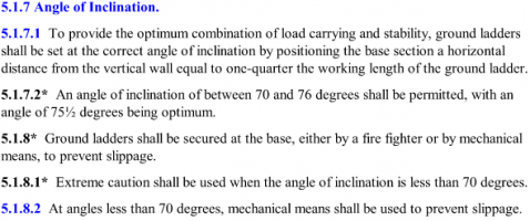

Here's the NFPA 1932 excerpt that I found online:

Again....5.1.8.1 and 2 imply that angle less than 70 are allowable...
And going in the other (steeper) direction, per 5.1.7.2, the phrase "An angle of inclination between 70 and 76 degrees shall be permitted" does NOT expressly prohibit other angles, either higher or lower.
Otherwise , if they intended it to be exclusionary, they would have said "the angle of inclination of the ladder shall be 70 degrees minimum and 76 degrees maximum".
