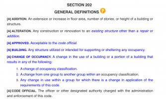

In the IEBC the definition of Change of Occupancy is broader than only a change of occupancy classification. It includes a change of use within a group.
