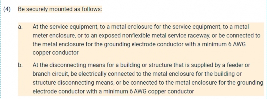

  • (4) Be securely mounted as follows:
    • a. At the service equipment, to a metal enclosure for the service equipment, to a metal meter enclosure, or to an exposed nonflexible metal service raceway, or be connected to the metal enclosure for the grounding electrode conductor with a minimum 6 AWG copper conductor
    • b. At the disconnecting means for a building or structure that is supplied by a feeder or branch circuit, be electrically connected to the metal enclosure for the building or structure disconnecting means, or be connected to the metal enclosure for the grounding electrode conductor with a minimum 6 AWG copper conductor
  • (5) Be listed as grounding and bonding equipment
But if it is supplied by a feeder, it is not a service (No SE)......And I've never seen it metered other than a service (No MEE)....? I am so confused....

The parsing:
". . . external to (enclosures at the service equipment or metering equipment enclosure) and (at the disconnecting means for any buildings or structures that are supplied by a feeder or branch circuit)."

So if you are saying this.....I need it at the meter AND at the disco......For grammars sake...
On a building supplied by a service, you need it at the "service equipment or metering equipment enclosure".
On a building supplied by a feeder or branch circuit, you need it at "the disconnecting means".
