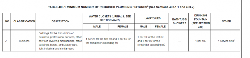

This practice question says the office building has occupancy of 400 total. 200 men, 200 women. The answer explanation used the 400 occupancy and Table 403.1 in the #2 classification to reach the number 9 total water closets.
I computed my answer of 10 water closets like this: I included IPC 403.1.1 because I thought that meant I would divide the total occupancy of 400 in half, so 200 men need 2 water closets for the first 50, and 3 more for the remaining 150, total 5. Then 200 women also need 5 water closets for a total of 5. Grand total 10 water closets. Urinal substitution per 424.2 didn't enter the equation so I ignored that. But that's the wrong answer. I see how they got 9 but I need to clarify my process.
My question is this: when I look at Table 403.1 and there is no vertical line separating men and women, like there is no line in the men/women box for business classifications and the ratio calculation just covers both sexes....then does that mean that each bathroom will actually be a single room with just a single water closet and a single lavatory opposed to a group bathroom with 5 water closets in individual stalls? Maybe that's a design question, but I'm looking for a clue why the fixture calculation is sex segregated in some but not others, and why the question did not divide 400 occupancy in half.

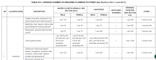

likewise, In theaters and assembly buildings there is a line between the men and women columns so that means those are group bathrooms that will be segregated by sex? And if a total occupancy of a Theater (#1) is say, 2000, then I would divide that into 1000 Male, 1000 Female...and have 8 Men's Water Closets in a group bathroom and 15 Female water closets in another group bathroom?

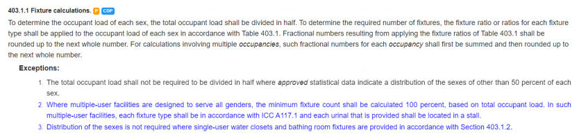

The question asks for the minimum, which I have normally computed the way you did it. However, if using all single user toilet rooms, identified by for use by either gender, then you get one less. so that is the minimum number. I see this from time to time, but never for 9 single user toilet rooms. When this first started to happen I had DP's try to have it both ways. They would compute based on one gender (200=5), then claim that since either gender could use them that is all they need. My take is you can do it either way, and take the lesser number, but it rarely presents a reduction, and if so it is minimal. My guess is that the question is doing it the same way. The 2021 IPC added a paragraph to 403.1.2 that says the total number is permitted to be based on the required number of separate facilities or on the aggregate of any combination of single user facilities. I THINK this codifies the approach I describe, but as usual the writers of the code did not take in to account my limited ability at interpreting their words.

403.1 tells you to split for gender first and then multiply the ratio. 403.2 tells you when you have to provide separate facilities for each sex. If your count is low enough you can provide a couple unisex restrooms, but cross one of the thresholds and you have to separate.

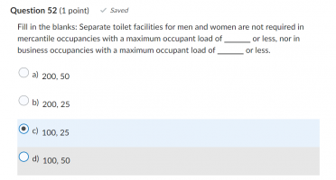

Separating facilities is 2021 IPC 403.2
That line between MALE/FEMALE in the Table 403.1 just simplifies the calculation.
403.2 is what determines the thresholds
Because the business/office has a 400 person occupancy that exceeds exception #4 there will definitely be separate facilities. 5 Female, 4 Male wc. How they are arranged is another topic.

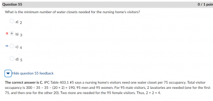

super annoying. I get a very similar practice question and it explains the right answer using the exact process that got me the wrong answer in the other question.

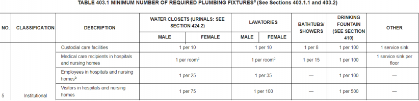

It divides sexes and then computes the ratio from the divided number instead of just going with 70 total employees and 190 total visitors and 40 residents.
The Table does not separate MALE/FEMALE so I just used 190 total visitors. 1 w/c for the first 75 and 2 more for the remaining 115 for a grand total of 3. But nooooo. that's wrong. In this case I'm supposed to divide 190 into 95 Male and 95 Female and reach 4 total water closets.
What this teach me is to divide the total occupancy in half by sex and then compute the ratio TWICE using the same calculation in the table, instead of taking total unisex occupancy and computing the ratio ONCE with the calculation, which will always leave me short a toilet or two. Jeeez. Why the office building occupancy was not divided is a mystery.

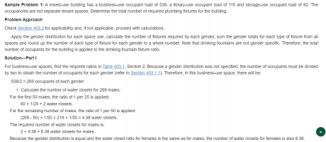

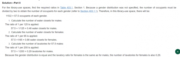

This sample problem I found in the Commentary portion of the IPC answers my question about when occupancy # is divided in half by gender. The answer is ALWAYS. Always divide the number in half by gender. The line that separates the MALE/FEMALE water closet column in the Assembly classifications doesn't mean anything except to remind you there is a different ratio per gender. The study guide question I found in post#1 that just took a total occupancy and applied the ratio to the total # is wrong. Even if the bathroom is a single use room, you should still reach the final minimum fixtures by applying the ratios to both genders. Assembly classifications have different ratios for MALE/FEMALE because:
"The buildings or spaces having these use descriptions have historically had numerous situations where there were long lines (queues) of females waiting to use toilet facilities while male facilities had very short or no lines. The reasons for this include the following:
  1. 1.For a variety of social and physical reasons, women generally take a longer period of time to use the facilities.
  2. 2.Women somewhat outnumber men in the general population and this becomes especially evident in large groups of people.
  3. 3.Women, in general, tend to use the facilities more frequently."
And in assembly classifications this difference in bathroom use is most obvious causing long lines so they get different ratios. "The potty parity" The other classifications don't have big problems with lines so they get the same ratio, but will often be a group bathroom separated by gender.
Only when the occupancy gets an exception specified in IPC: 403.2 do bathrooms become single-use rooms.
The Business will have group bathrooms, the library will also have group bathrooms but the storage-use building will probably have 2 single use non-gender bathrooms because that will satisfy 403.1.2 code about single use facilities counting toward the required number. It is noteworthy that they do not round up the subtotal fractions until the last stage because that would start to increase fixtures beyond the maximum.
