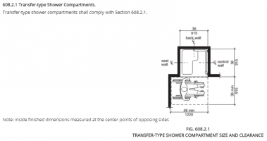

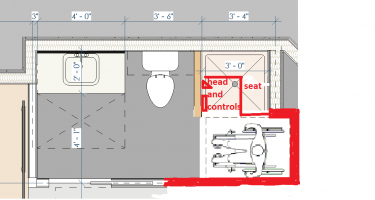

Does the dimension below need to be 3ft per 403.5.1 Clear Width or would there be some exception here?

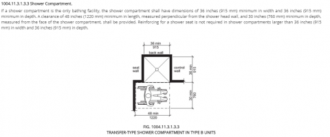

Looks good to me (if it is a side transfer) for a Type B unit.
Do note that if full accessible use is required (accessible or Type A unit), it bumps up to 36-inches. This can be one of the bigger issues when converting b/w Type A and B.
36" is "better" practice to prevent wall damage, is this intended to be a roll-in or transfer to a seat?

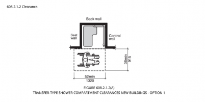

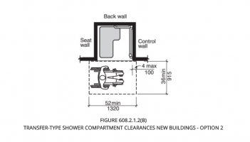

It does not comply with a side transfer shower. there is no way, to transfer. the wheels get in the way, you will be out of position. That is why there is an "alcove", for the wheels, in the Code/Standard drawings. you will be transferring into the side wall.
Mark - I think Ryan is saying that (in his opinion) if the wheelchair were to head straight in (instead of backing in as your illustration shows) that the area needed for the rear wheels would protrude into the room and not require the additional bump out.
IMHO Still won't have clearances
