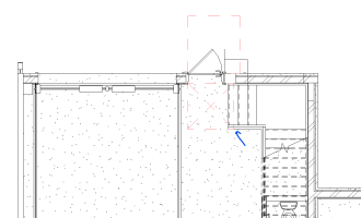

Clearance at bottom of stair / door
coolethan
Jun 28, 2024
17
Texas
Greetings. I'm working on a private garage condo unit. Is there a minimal distance from the door to the stair? I have read 24".. however, why couldn't I just provide 12" on the push side? Also assuming handrail can't overlap into the clear space too?
Thanks!

Based on the answers above - This appears to be a door from the living space of a private dwelling unit to the private garage (this tenant only) attached to that private dwelling unit. It is not the primary entrance to the unit. This is not an accessible unit. It is a multistory unit (stairs are within the private dwelling unit). Is all of that true? If so, there is no code requirement for 24 inches or even 12 inches to the door jamb.
Sorry, to clarify.. the door is on level 1 and the only exit outside of the unit (besides the adjacent garage door). The 4th wall (missing in photo) does not have any doors (just an exterior wall).

Or maybe your original question could be restated as: do I need the maneuvering clearances hinted at by the red dashed lines in the floor plan?
Is that what you are trying to ask?

When they leave the unit - through the single exit door by the stair, they are standing outside - on the drive aisle (which is drive between each of the buildings - that house 4-5 units per bldg).
Correct.. just trying to nail down the clearance requirement between the door and the bottom of the stair. Since the unit wont require ADA door clearances and considered residential, can the stair lowest tread / riser be located.. lets say, 12-18" from the door frame?
As an industry convention, the red dashed lines on the doorway in the sketch you provided are typically used to identify additional clearances required by accessibility codes for persons with disabilities. Here in California, that is CBC 11A for privately funded housing and 11B for publicly funded housing. At exterior doors, we typically have 24” on the outdoor pull side of the door. That goes down to 18” for interior pull side.
For the interior push side of a door, it typically does not have extra clearance required unless that door is equipped with both a latch and a door closer, in which case the clearance is 12” for a distance of 4 feet back from the door.
Looking at your drawing, if the designer was being very intentional about meeting minimum code requirements (and wasn’t just copy/pasting without thinking),
1. The designer thinks there is some accessibility code that applies to this project. Have you researched this to see if the codes will require the door to be accessible?
2. You’ve said the door opens to the outdoors and you also said the door is rated and has a closer: Why does this door need to be fire rated? Why does it need a closer? Are the cars in the drive aisle going to hit it if it stays open? If you don’t need the closer, the 12” clearance goes away. Alternatively, if you want the door to close without a closer, you can use spring hinges and the 12” clearance goes away.
Lastly, if your designer really thinks the unit need to be accessible, you should also double check to make sure the code doesn’t;t require handrails extensions at the stairs that would interfere with the doorway. It’s probably unlikely inside a private dwelling unit, but we don’t have enough context from the info provided.

With regards to the door, the closer, door rating is a client preference. And yes the door red dashes is from the modeling.. not necessary a requirement, just a drafting convention typically used by the designer. The units don't have to be accessible.
The portions of public or privately funded apartments, condominiums, townhomes, and single-family dwellings used exclusively by residents and their guests are exempt from compliance with the Texas Accessibility Standards, per 68.30 (4). Texas Administrative Code (state.tx.us)
The 2021 IFC below has a requirement for the stair, however the door swings outwards and doesn't overlap the landing. The track of the overhead garage door will clear the 48" requirement as well.
If we reconfigure the stair to have 1 less tread, this will provide 12" of clearance from the door frame as well.

This will not get you out of FHA requirements. You may be subject to them with some units if there are 4 or more in a building.

I agree with redeyefly. You will be subject to Fair Housing Act due to having 4 or more condos per building.
Fair Housing Act is not enforced by the building department during plan check, so don't expect this to be a plan check correction. Rathr enforcement occurs when you get sued for discrimination in civil court.
To avoid that, design per the Fair Housing Act Design Manual, found here: https://www.huduser.gov/portal/publications/PDF/FAIRHOUSING/fairfull.pdf
PDF page 130 has this comment:
So you need to check out ANSI 4.13 (or its predecessor, since this was first published in 1998) to see what the clearance requirements are.
My guess is they are similar to the red dashed lines on your drawings.
Honestly, if I were you I'd get rid of the closer, and if the owner's preference is for the door to close automatically while avoiding strike side clearance issues, then use spring hinges instead of closers.

Right, and the OP has not clarified the full scope of the project. We don't know if the building has an elevator or not, because we've only seen one small portion of one room in one unit.
The project is subject to FHA; but whether that analysis indicates FHA compliance via zero CMD vs. via units that require an accessible primary level remains to be seen, based on elevators. Excerpt from FHA.

Per TAS, you need handrails on both sides of the stairs, and must extend 11-inches minimum, beyond the bottom stair tread
Architectural Barriers Texas Accessibility Standards (TAS)
505.2 Where Required. Handrails shall be provided on both sides of stairs and ramps.
505.10.3 Bottom Extension at Stairs. At the bottom of a stair flight, handrails shall extend at the slope of the stair flight for a horizontal distance at least equal to one tread depth beyond the last riser nosing. Extension shall return to a wall, guard, or the landing surface, or shall be continuous to the handrail of an adjacent stair flight.
