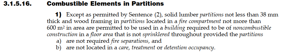

Canadian Code would allow this. Millwork/Cabinets [NBC 3.1.5.9] and minor components like blocking and "similar" are accepted [NBC 3.1.5.2.]
I'd also rely on this:
Kinda interested to see what the 'Murican Codes would allow.
