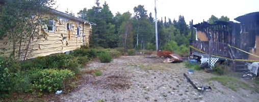

Distance between the two buildings: 10.2 metres. These were trailers on the same property, outside a 10-minute response area, but not remarkably distant from the nearest fire department.

Dont get me started with mobiles and mobile home parks. We have a park in town where (again) I am the first inspector in generations to enforce spatial separation. Added to this, the park butts up to a beautiful mature forest of spruce and pine, its a wildfire disaster waiting to happen.
We have had multiple fire in this park in the last 5 years, including a fatality. These things are designed to burn.
