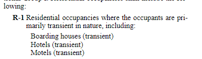

Section 310.2 doesn’t mention dwelling units in R-1, so it seems like that makes them R-2. Can dwelling units be R-1?
If I understand the term correctly (had to look it up), a condotel has a front desk, hotel staff, housekeeping, etc. If it’s a central operation using the residences as inventory that is going to be an important ADA issue.
Fixed in 2024 much to the chagrin of the short-term rental community:
Apparently so. The language of 310.2 includes "sleeping units," which is italicized. The definition of "sleeping unit" in chapter 2 says they can have kitchen OR sanitation facilities, but not both. So if an "accommodation" (for want of a better term) includes both kitchen and bathroom, it's not an R-1. But the discussion of R-2 in 310.3 includes both sleeping units and dwelling units, but R-2 is for occupancies "where the occupants are primarily permanent in nature."
Strictly speaking, then, the IBC overlooks all-suites hotels, where the occupants are transient but the suites include both kitchen and sanitation facilities. That said, since R-2 is specifically limited to non-transient occupants, I think the logical classification for a condo hotel, like an all-suites hotel, is still R-1. The IBC Commentary for R-1 seems to agree:

Which is why it was fixed in 2024
Yes, which now gives us intent. They did not change the code, they clarified the intent with verbiage changes. This now gives the AHJ the ability to exercise her/his authority to interpret the code based on the clarified intent regardless of what code cycle you are on.
Well...they "changed it" back to what it said in 2003 (sorta) which was focusing on the transient nature more so than the unit....Someone tried to make it clearer which actually screwed it up, which is happening a lot these days...
