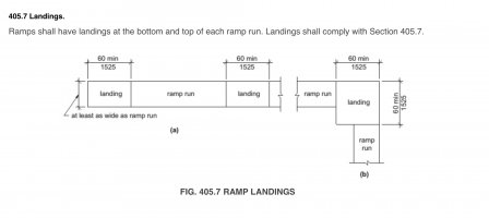

Exception 2 is confusing to me.
I'm really looking for minimum dimensions to the landing, and the wording of exception 2 doesn't really provide that.
Anyone have any insights into this?

A117.1 has a graphic where the length is shown as 60 inches. IBC requires the same length but has an exception to reduce the minimum length to 48 inches when the ramp is not part of an accessible route.

I would say that, editorially, they put the two exceptions in the wrong order. The way I think it shakes out is, for ramps that are part of an accessible route, the landing length has to be at least 60 inches. For any ramp that is not part of an accessible route, the landing length can be 48 inches in length. THEN -- for R-2 and R-3 dwelling and sleeping units only, if they are not accessible or adaptable units the landing length can be as short as 36 inches.
