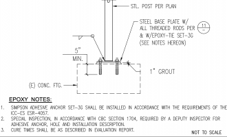

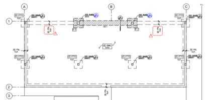

Here is an example of incomplete approved plans. The scope of work is replacing posts and headers that support two existing second floor apartments. The plans state that the footings for the posts and either side of a grade beam at the front of the carport shall be verified in the field. It has been verified that there are no footings for the posts and there is no continuous footing at the front of the carport. The plans do not provide any indication of what the footings shall be. The note on the plan should have been, "(E) V.I.F. and get back to me."
Then there is note #1. That should include, "Give me a call and I'll explain what I was trying to say there."
