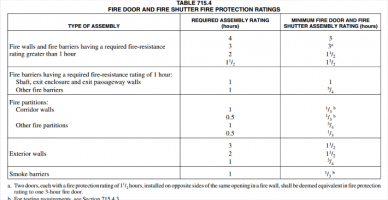

Can someone please explain to me the fire door requirements in a sprinkled building or where I can find that information? I'm looking for the actual code telling me what the doors should be rated in a particular rated wall and how it breaks down.
Which edition and building code do you want referenced
The answer can vary
Normally worse case scenario 20 minute door.
Where corridors are not rated, can have any type door to no door at all
The wall rating may change based on sprinklers but the opening protective rating is driven off of the wall rating...And I believe all rated walls need rated OP....At least 20 min.
