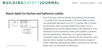

Reach over counter in kitchen
Only the sink and the work surface must be 34” AFF.
Keep in mind that operable parts associated with the sink or the work surface must comply with the requirements for an obstructed forward reach in 4.2.5. Even if you have a removable cabinet under the sink, it is still a forward reach because the assumption is that if someone needs that knee and toe clearance, the cabinet will be removed. And it is the operable parts that can be no further back than 24” or 25”. The counter can be deeper unless you have outlets on the wall. The outlets can be moved out if the wall is further back.

Here is one opinion, written by an ICC staff member on the subject.

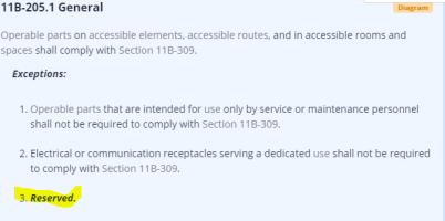

205 Operable Parts
205.1 General.
Operable parts on accessible elements, accessible routes, and in accessible rooms and spaces shall comply with 309.
EXCEPTIONS:
3.
Where two or more outlets are provided in a kitchen above a length of counter top that is uninterrupted by a sink or appliance, one outlet shall not be required to comply with 309.
That exception #3 will work except for my new construction projects in California, because (yes, once again!) California has eliminated exception #3.
