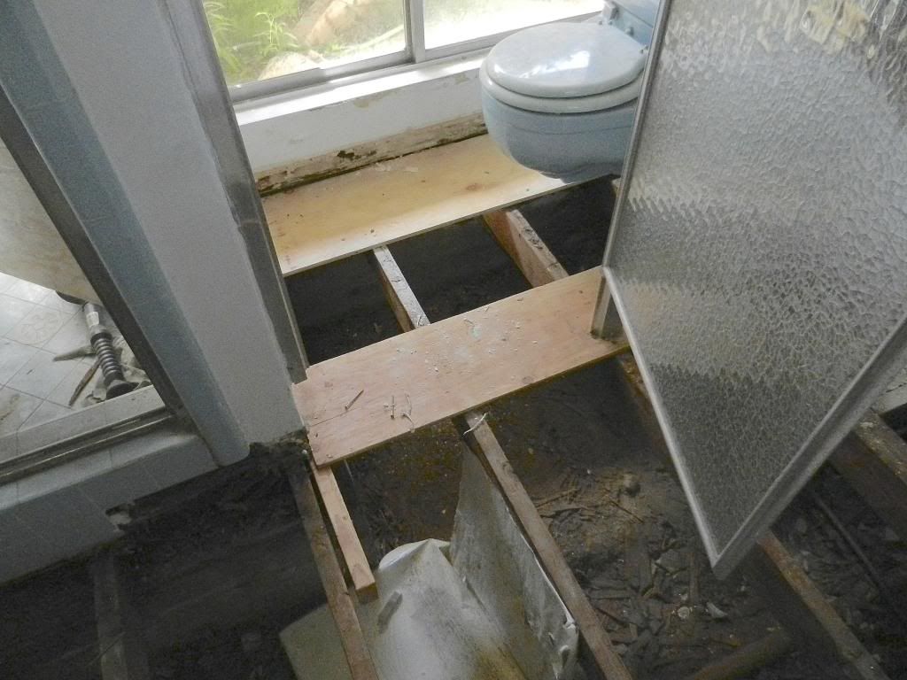

This is how it started. The plumbing was leaking. The 88 year old owner found a general contractor instead of a plumber.

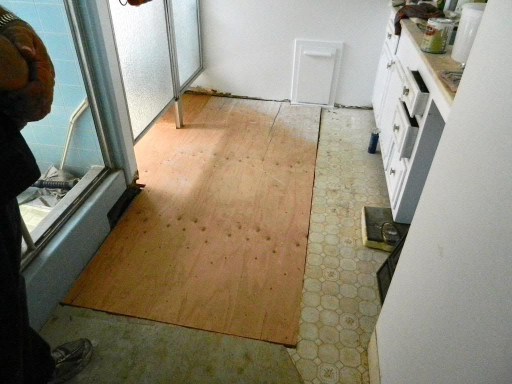

I was there to inspect the plumbing that was replaced. I found part of the floor covered with 5/8 plywood.

I asked that the plywood be removed. There is no T&G or backing of the edges.
