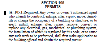

Hi,
In a manufacturing plant, installing a powdercoating cure oven, is a building permit required? I can see an electrical permit & Fire Marshall permit, but not a building permit.
We're installing a powdercoating oven, our local county is saying we need a building permit, but i say since oven isn't connected to the building, neither is the fire protection, no building permit is needed. We have the prints from the manufacturer of the oven to submit, prints will be provided for fire suppression, and will provide prints for electrical, if needed. Co is wanting an overall stamped engineered drawing with everything all spelled out on it.
I look at it like installing any other piece of equipment, like a lathe, welder, sewing machine, microwave, toaster, TV, grinder, etc. Maybe get an electrical permit, but get a building permit when no building is being built, or modified? I just don't see it.
What would you guys here say?

Referencing the 2018 IBC, but is applicable to previous editions, organic coatings are addressed in Chapter 4, Section 418. If you're replacing an existing oven, then there should be no need for a permit. However, if you're adding a new one, especially in an area that previously did not have one, then you're altering the use of the building and a building permit is required.
We are adding another oven, directly beside an existing oven, same usage, not replacing, just adding.
Another thought, we have three maintenance men, they do repairs all day long, daily, on machines, building maintenance, vehicles, etc. They do not pull permits to replace a toilet, replace a light bulb, sweep the floor, plug in a welder or toaster. Repairs can cost more than this machine we're installing, no permit. Are we to pull permits to change a lightbulb, or plug in a toaster? If not, and this requires one, where is the line? I don't think there is one, no building permit required to install free standing shop equipment. Maybe an overhead crane, for example, thats part of the building frame, that requires building modifications to install I could see a building permit, maybe.
They issue, I'm in NC. They're quoting NC building codes, not county or city, specifically 101.3.2.1 technical code. Which doesn't say anything about equipment installed in a building, not part of the building.
101.3.2.1 North Carolina Building Code The provisions of the Building Code shall apply to the construction, alteration, repair, equipment, use and occupancy, location, movement to another site, removal and demolition, or any appurtenances connected or attached to every building or structure, other than one- or two-family dwellings and townhouses.

The AHJ can and should make the determination if a permit is required based upon the information you provide them.
So far, you have not provided sufficient information. How large of an oven is this - is its weight an issue, building construction (combustible, permissible structural loads,etc.), does it block or impede egress, does it alter max occupancy, etc.? Some ovens can have a trailer parked in them, others no bigger than a household appliance.
The AHJ, who probably has more info then us here, will need to consider the scale of this oven to determine what is required.
IMHO If it is an oven with an exhaust system as required by the manufactures installation instructions then it would need a mechanical permit. If you are installing a new electrical circuit to operate the oven then an electrical permit would also be required.
The oven, unlike a toaster, is a structure you can enter and exit. Is it larger then 120 sq. ft?
