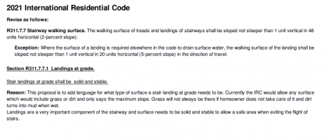

Define "solid" and "stable" please. Is there a measurement system?

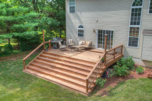

Like the grass and dirt example, a million dollar wood landing becomes a hazard without maintenance. Curiously, it only applies to stairs, not doors as the thread discusses. It would be somewhat more tolerable if it was at least related to stairs required for egress. And do you intend for this to apply to the stairs - maybe just a few risers - from a deck to the ground, like pictures below?

If you look at the picture I posted in #16, do you really think a 3' strip of pavement at the bottom of the cedar stairs would be any safer or look good at all? The question was never about not spending money, as the OP pointed out, but safety, aesthetics, and what the code requires. The question was not what you all like, but what is required by code.
Does "solid" does that mean you can't have spaces between the deck boards on the landing or you can't have stairways and landing like this:
Or does it mean other than liquid or fluid. Will need a definition if using "solid".
