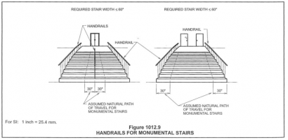

2006 INTERNATIONAL BUILDING CODE® COMMENTARY
The criteria for monumental stairways deals with the very wide stairway in relation to the required width.
While handrails on both sides of the stairway may be sufficient to accommodate the required width, the handrails may not be near the stream of traffic or even
apparent to the user. In this case, the handrails are to be placed in a location more reflective of the egress path (see Figure 1012.8 for handrail locations for monumental stairs).
Figure 1012.8
HANDRAILS FOR MONUMENTAL STAIRS
Basically, handrails are required on each side of a stairway. They must also be available within 30 inches of "the most direct path of egress travel". If the stair is wider than 60 inches, Intermediate Handrails are required to meet this 30 inch maximum. A 20 foot wide stairway would need the 2 outside railings and 3 intermediate handrails if it were serving continuous doors. However, the "most direct path of egress travel" in this case is up the sides since that is where the doors are located. The center area would not qualify as an egress travel path since it does not serve any entrance doors. This would exempt it from the Intermediate Handrail requirements.
See IBC 1009.10 and IBC 1012.8 for details.
Figure 1012.8

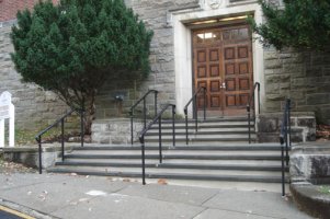

This picture as you can see has a single door existing the building with full building width stairs, the handrails were provided in the direct egress path
bronze_1-jpg.8373
These stairs are approximately 45' in width, the 2 walls have handrails and then there are 2 center double sided handrails in the middle. There were 3 sets of double doors opening on to them from a small church and the egress only required two 60" paths of travel. Hence 4.5 times larger than required. The picture was taken just before we installed the stone wall handrails so you don't see them in the pic., but they are there.
bronze_7-jpg.8374
This last stair only required one 60" width for it's required egress width. With the doors parting in the middle the center handrails supplied the requirement for the over sized staircase, the lower outer handrails for travel path.
monstair1-jpg.8375

Photo indicates differring riser height at grade, trip hazard
I will assume you are referencing the bottom of the 3 photo's which you would need to take it up with the DOD, since they told us go pound sand when we brought it up.
That is the historic Thayer Hotel at West Point Military Academy, built in 1829, keep dreaming.... installing the handrails was a 2 year battle to get past the Historic Overseers.
