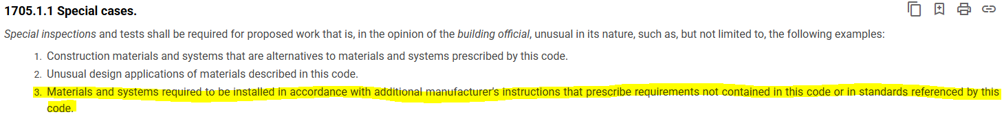

Lets bring this subject back up on destructive testing. Would you make the same stance for firestopping and fireproof patching? Special inspections for firestopping only kick in once certain thresholds are met or the BO requires an SI for firestopping. My question comes down to smaller projects and you need to verify the system was installed per the listing?
Nothing in the code prevents a building official from doing destructive testing if necessary to verify compliance. It is expected by the code writers and firestop experts that random destructive testing is the only way to verify compliance on firestopping systems other than physically watching the system be installed.
While I have not done it, I would fully support and suggest it...As I know how often it is wrong...I require FS SI on all multi story wood project through IBC 1705.1.1
