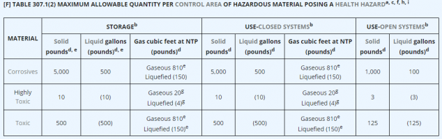

Agree with Enri for the most part; however, keep in mind that chemicals posing a health hazard can still push you into an H. See my previous post and IBC Table 307.1(2).
(Note that footnotes not included)
Yes, chemicals posing health hazards can indeed still possibly trigger an H occupancy based on parameters in the code.
Knowing what kind of chemical hazard we are potentially facing helps in knowing where to look in the code and more importantly what kind of mitigation measures we may need to do.
