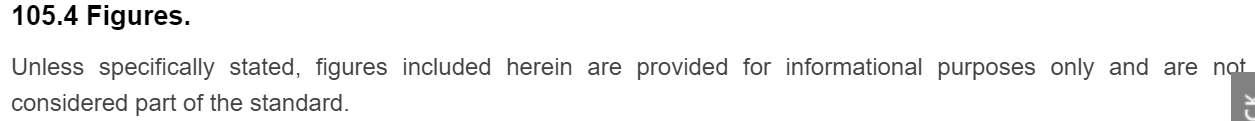

I'm wondering if anyone has ever seen a set reference external sources IN LIEU of drafting the diagram itself.
I have never seen this before. People I’ve worked for print their drawings for use on site. They want to lay them out on a table and be able to have people stand around to discuss the project, point to things on the drawings, write notes on the drawings, et cetera. Even if they had a PDF with the links as you describe I expect they’d sooner call me then click the link - and I’d rather they called me instead of trying to find the answer themselves so I can confirm they understand the intent of the drawings. I would then follow-up with an email so all parties have a record and attach a PDF of a drawing if needed. But I wouldn’t use the link system, I’d put the information on the drawings.
I would recommend against either referencing “external sources” (such as to have a note that says, “Provide accessible grab bars per A117.1 Figure 604.5.1”) or simply reproducing Figure 604.5.1 on your drawings.
Regarding using a note referencing Figure 604.5.1. That diagram has a lot of dimension ranges on it, so someone has to determine what the specific dimensions to use will be. It’s not the contractor’s responsibility to make design decisions regarding accessibility (or whatever) - that’s the architect’s responsibility. Someone has to make this design decision (picking a dimension,) I’d rather it was you (one person who knows how/if decisions regarding the grab bars might affect other parts of the project) than to hope the general contractor coordinates the work of at least three other people (the framer installing the blocking, the person ordering the grab bars, and the person installing the grab bars.) For sure there are contractors who can do that, but I’d rather we made the decision before drawings are printed and given to the contractor.
By reproducing Figure 604.5.1 you are stating general requirements that apply to every project with a toilet - I would prefer to see the specific requirements that apply to the specific constraints of your project. Stating that a grab bar should be installed from 33” to 36” is not specific, I want to see a dimension that says 34” or whatever single dimension you choose.
