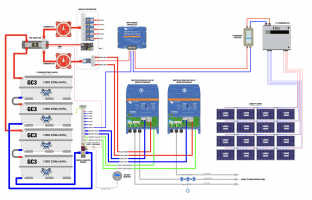

Builder owner in Coconino County (2017 NEC) working on my ground mounted solar. Working on the labels and final design and unsure whether I need an AC disconnect when there is only one AC source to the main panel. Does the main panel act as the AC disconnect? The inverters are about 30ft away and did read something about a 10ft distance but was confusing.

Its fully designed. plan inspector loosely said to put placards so people "didnt get shocked". its working. Am asking about whether the main breaker needs a placard when acting as an AC disconnect. Its cool.

Got one line, 3 line etc... Just need to get the placards sorted out. Bare minimum is fine - they are pretty lax since its my own build. Got most of them done but wasnt sure if I needed to add the AC disconnect placard on main breaker when its only one source.

Because the way in which the solar is connected to the rest of your premises wiring will determine what role(s) if any the main breaker plays as far as the requirements of Article 690 of the NEC, and its signage requirements.

Gotcha. Attaching 1-3 liners. Screenshot 2024-01-26 at 7.22.43 PM.pngScreenshot 2024-01-26 at 7.22.09 PM.png

The detail required is everything not shown in your diagram. Everything on the AC side of the inverter up to the meter.
Also, do you have any DC load attached as shown? And does the system support AC backup, or when the grid goes down do you lose power to all AC loads?

Opps missed the notifications... No DC load - maybe someday but unsure. Actually took that 24VDC bank off the diagram. I do have generator support though its currently a manual crank thing. But it feeds into the Multiplus directly so just one line going to main breaker. Plan reviewer is fine w no AC disconnect or label since its the main breaker.
