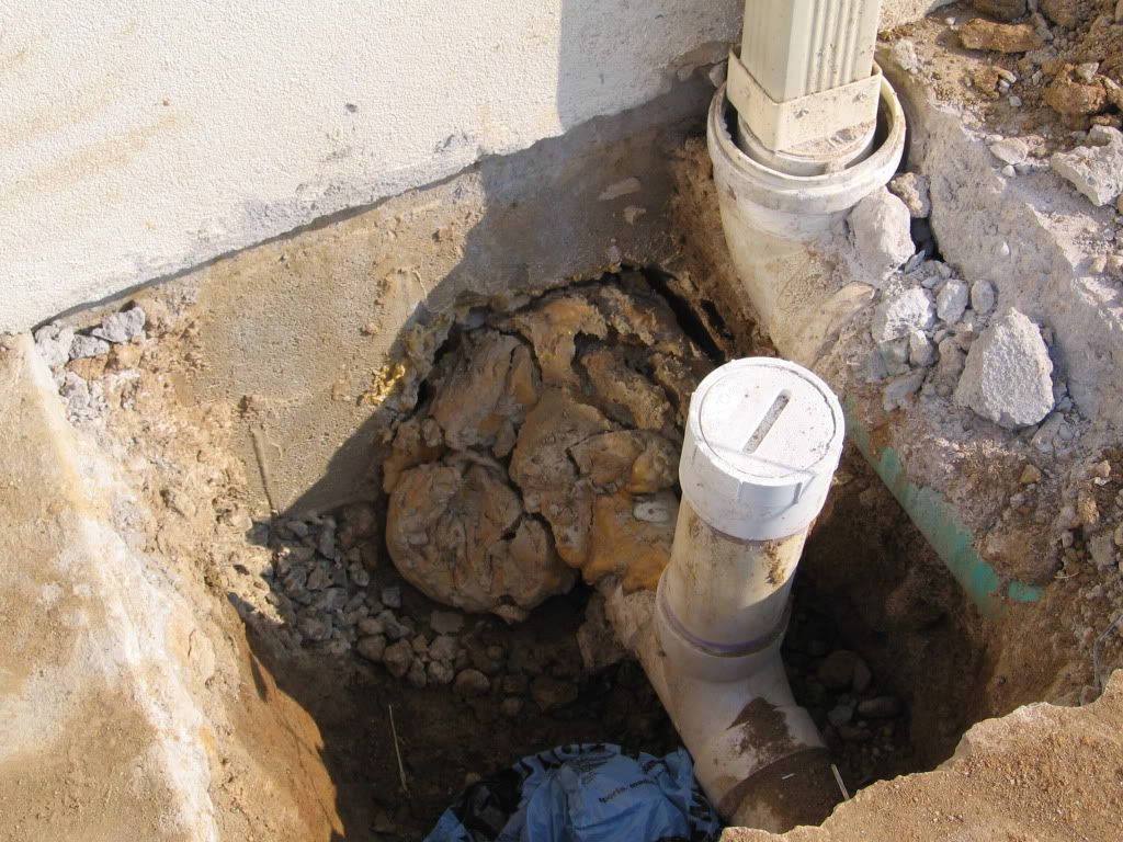

What is missing?
Maybe a pipe sleeve / relieving arch for the pipe passing through the footing.# # #What is missing?
