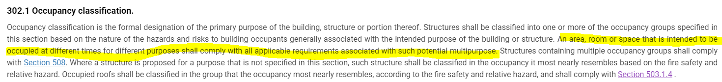

With a stage, you still have to provide all the requirements required for a stage in Chapter 4, regardless of the occupancy classification. You also have to comply with the exiting and aisle requirements per Section 1030. In other words, the stage itself does not dictate the occupancy classification, but as @steveray states, you have to comply with all of the requirements for those times when a space is used differently from its primary function.

steveray seems to have this right by 302.1 "An area, room or space that is intended to be occupied at different times for different purposes shall comply with all applicable requirements associated with such potential multipurpose." which I think poorly says the most restrictive provisions of the all intended uses.
