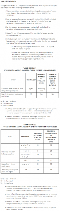

Does the story on which the dwelling units are located have two means of egress? If yes, then EEROs are not required.

If you are looking at the IRC (re: your reference to R310), then don't. A high-rise residential building is not subject to the IRC (See IRC Section R101.2). EERO requirements for commercial residential occupancies are located in the IBC in Section 1030 (2018 IBC).
The unit and even the room can have a single exit. An EERO would be required for sleeping rooms if the story on which the unit is located did not have access to two exits. Besides, EERO's, when required, are only applicable to stories below the fourth story and basements. At the 16th story, an EERO is absolutely not required.

The unit and even the room can have a single exit. If the story has a single exit, then an EERO would be required for sleeping rooms if the story on which the unit is located did not have access to two exits. Besides, EERO's, when required, are only applicable to stories below the fourth story and basements. At the 16th story, an EERO is absolutely not required.
FYI- This means you are not allowed to build a building that high without at least 2 exits
