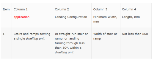

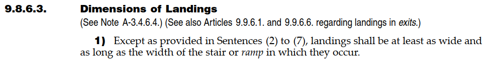

The Canadian codes are different than the US codes, there are several Canuk's here, hopefully they will weigh in, but that's why
@Yankee Chronicler suggested posting it in the Canadian section.
If it were Ontario, CA, a landing would be required. There are some exceptions, but none seem to fit the scenario you're describing. We would cite:
