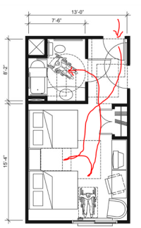

Hey!
Any advice appreciated on this, can door push clearances and Door swing overlap each other? Like the one in the image?
I’ve done some research and was not able to find something definitive, or maybe my research or understanding might be deficient…
There is no prohibition in either the ICC A117.1 or the ADA/ABA Standards against doors swinging into the maneuvering clearances of another door.

Really appreciate the input and link. This is super helpful.
The doors are in a bit of a bind, but the door with clearance in red opens into corridor on either side and the other door opens into a room. But as far as the link goes, I think they don’t fall in any of those situations…

Do both of these doors have closers? Could you argue that the door to the left has a hinge approach rather than a front approach?
If there's concern (code or practice) with the maneuvering clearance and door swing, removing the closer or calling for a hinge approach may be sufficient to get the maneuvering clearance out of the door swing.

Apologies for the delayed response. I was trying to get more information on this lol, the door to the left is a secured door which has closer, the right one does not... You think this could be an issue if these are considered a series of doors? Thanks
It's possible. Most jurisdictions I've worked in wouldn't consider this doors in a series. There is one, however, that would undoubtable consider this doors in a series.
Odds are you're probably okay.
ADASAD 304.4 allows doors to swing into a turning space, so I think that a door swing can overlap a maneuvering clearance as long as it leaves a clear 30" x 48" space for a wheelchair.
