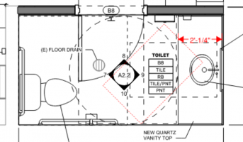

2017 ICC/ANSI 117.1, existing building:
Doors are not allowed to swing into the clear space of a fixture unless a clear floor space is provided beyond the arc of the door. The clear space can be at any angle. Clear space is permitted to include knee and toe space, and extend up to 25" under an element. Would the following comply for the exception for door swing into the clear space with the diagonal clear space extending under the lavatory? The red lines are mine. I think yes, but this feels very awkward, requiring the user to back in or turn around with the door open and then maneuver into a position under the lavatory to close the door before swinging around to back in beside the water closet. (when I write it out that way it feels even worse)
I would cite code for a deficiency. I can't make a door swing citation since there is a clear space beyond the arc of the door per 603.2.2 #2. I can't make a clear space citation because there is a 30"x48" clear space per 305.3.2, I can't make a knee and toe clearance citation because it is permitted per 305.4, I can't cite knee and toe clearance under the lav per 306.2.2. What code would you reference for not permitting it? All of the illustrations in the ANSI standard show the clear space beyond the swing of the door, and at various angles, but none show that clear space under any elements. If they did it would be clear, or if they prohibited under the exc. for 603.2.2 it would be clear. This is a case where I may not like it, but I can't find a code to cite. And as you yourself have said, if a code can't be referenced, there is no violation. I happen to agree 100% with that philosophy, and apply it daily.
The only thing I keep coming back to is clear space approach, but I think the side approach works as the user enters so that is a tenuous link.
I am still on the 2009 ANSI and it looks like a very tight fit. If the knee space can get that close to the drain on the lavatory it complies to the 2009.
You DON'T have a 30" x 48" clear space. Knee and toe projection beneath lavatories and countertops applies to approach/maneuvering space. It does not extend to the 30" x 48" clear floor space.

Hmm, 305.4 & every single illustration seems to contradict that. What code would be cited for this violation? My first reaction was in agreement, and my comment was to provide the clear space beyond the arc, then I realized it is there, but under the sink. Totally agree it is clumsy, bit I don't have a code reference for that.

I haven't assumed anything. Let's break this down, based on the 2009 A117.1:
Clear floor space is addressed in section 305. 305.3 establishes the size at 30" x 48". 305.4 says "Unless otherwise specified, clear floor space shall be permitted to include knee and toe clearance complying with Section 306."
Now we look at section 603.2.2 for doors in toilet and bathing room. The starting point is that doors may not swing into the clear space for any fixture. Then there are two exceptions. Exception #2 says "Where the room is for individual use and a clear floor space complying with Section 305.3 is provided within the room beyond the arc of the door swing, the door shall not be required to comply with Section 603.2.2."
The clear floor space is not clear space for a fixture; it is independent of fixtures. In fact, it is the provision that allows for door swing to overlap fixture clear space. You are apparently relying on 305.4. However, 305.4 is not a subparagraph to 305.3 -- it is a separate paragraph, of equal rank in the hierarchical structure. The exception to 603.2.2 specifically references 305.3 and does NOT mention 305.4. Therefore, as I read it, 305.4 does not apply.
You may choose to interpret it differently. We've been doing it this way for decades and you are the first person who has ever questioned it. These requirements go back at least as far as the 2003 edition of A117.1, so it's nothing new.

The toilet room is a private room, serving a day room on the lower level of a fire station. The day room is not being altered, nothing in the entire building is being altered, except 3 bathrooms. I would say the lower level day room is not an area of primary function, but even if it was, it is not being altered, and per 305.7 "where an alteration affects the accessibility to or contains an area of primary function", and per the definition of primary function specifically excluding the toilet rooms, I am not sure I can enforce the provisions they don't comply with. Now, it looks like the intent of the design is to provide accessible toilets, so in that intent I think I will make the comments. If they can comply, they should, but I'm not sure I can compel it.

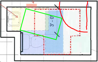

Find someone in a wheelchair to talk to. They will almost certainly look at our diagram and ask a practical question: "Can I place my wheelchair to the side of that door, and then open it?"
I see designers miss door access inside bathrooms way the heck to often. See attached, which suffered a hearty cluster of "verily, thou shalt readeth thine Codes and fixeth thy plan" yesterday: different codes at play up here, but same issue, in that the bathroom door, once closed, can't be opened by someone in a wheelchair, and quite difficult for someone using a walker.
Do they really need a vanity the full width of the room instead of a wall hung lavatory?
That was my first thought, but it is just a top, no cabinets so there is space under it for the full width.
It looks like at least one wall (with the door) is new. would you consider an alternate restroom layout something like this below, with 30x48 space shown in green, and the door moved down to one end of the restroom?
I am going to respectfully disagree....Unless you want to agree that would also mean that 305.2 would not apply and we could slope the clear floor space? And maybe 305.6 and it would not be required to be on an accessible route? I get maybe not all of 305 needs to apply, but I think some of it does....

That is a ridiculous reach. 603.2.2 says the CFS has to be "in the room". 305.4 is a general clarification and certainly applies. This is a very common design strategy for tight restrooms.
