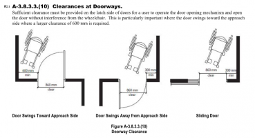

The following is from Ontario Building Code, Division B, Part 3:
3.8.3.3. Doorways and Doors
(10) Unless equipped with a power door operator, a door in a barrier-free path of travel shall have a clear space on the
latch side extending the height of the doorway and not less than,
(a) 600 mm beyond the edge of the door opening if the door swings toward the approach side,
(b) 300 mm beyond the edge of the door opening if the door swings away from the approach side, and
(c) 300 mm beyond both sides of a sliding door.
This is the Ontario Building Code Appendix A (explanations to the code):
It looks to me that doors equipped with a power door operator shall also meet the requirements of clear space addressed in 3.8.3.3.(10), while based on the wording of the above 3.8.3.3.(10), doors equipped with a power door operator need not to provide clear space on the latch side, which in my opinion is wrong, am I correct?

It is good practice to provide both clearance and the power operators, but the code allows you to eliminate the clearance if a power operator is provided.
you mean in case the, "power door operator" doesn't work... which means, in the case where the power goes out, you no longer have a power door operator.
Using a power operator is an acceptable compliance option when required clearances cannot be provided.
I'm always at least a little hesitant to play the "what if" game when it comes to code compliance.
What if the power goes out?
What if the button breaks?
What if the operator breaks?
All of these things could happen. However, if we accept the fact that the intent of the code is that if the power operator ceases to function, even temporarily, the clearance must be provided, We create two problems. From a code interpretation standpoint, 3.8.3.3.(10) now makes absolutely no sense. Secondly, we have created an environment that actively disincentivizes the use of power operators.
Without clearer code language to this effect, I do not think this interpretation would be upheld at higher levels.
