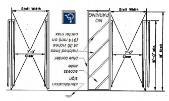

Therefore, in LADBS territory, striping for an accessible stall in the midst of standard stalls will look something like this:
In other words, you don't need to physically widen the stalls themselves, and LADBS allows you to change/relocate the striping locations of their normal double-stripe standard stall in order to achieve the stripe locations shown in the accessible parking regulations.

Adrienne, your image is not showing up in my browser. However, what the LADBS information bulletins are saying is that at the accessible stalls, LA will not require the double stripe: just follow the single stripe requirement for the ADA stall, and don't widen the ADA stall.
For example, let's say you had, left to right: (1) an 8'-6" wide conventional stall, then (2) a 14' ADA stall, then (3) another 8'-6" conventional stall. Let's say you were using 4" wide stripes. Without changing the actual stall size, your your LADBS + CBC + ADA compliant striping would be:

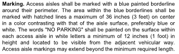

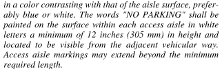

There is very little in the ADA itself that prescribes or prohibits pavement markings or colors, either on the inner edge of the ADA stall (in this example of a van stall the left/driver side, is what I will call the "inner edge"). Instead, the ADAS advisory refers back to local code:
The CBC gives you two options regarding marking:
- Option 1 (CBC 11B-502.6.4.1) does not require the left/inside stripe at all, but only requires the ISA symbol, plus marking the right side access aisle per CBC 11B-502.3.
- Option 2 (CBC 11B-502.6.4.2) allows you to mark the stall, including left/inside stripe in blue, plus the ISA symbol, plus marking the right side access aisle per CBC 11B-502.3.
Notice that in neither case are additional stripes or other markings (such as stall numbering, or colored/patterned paving, etc.) prohibited inside the accessible parking space or access aisle.
Thus you can have a double white stripe intrude into the accessible parking space and/or accessible aisle, as long as it is underneath any required blue markings.
