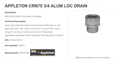

For installation of listed drain fittings,
larger openings are permitted to be installed in the field in
accordance with manufacturer’s instructions.

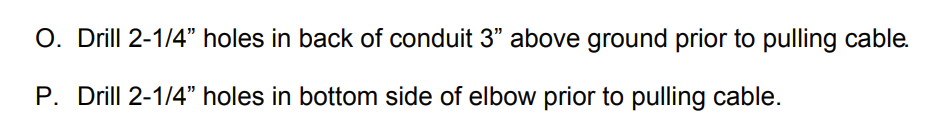

This has been common practice for years. Here is an example from PPL Electric Utilities that require drainage holes to be drilled into the vertical conduit and sweep for underground installations when installing the conduit for their service laterals.
Screen Shot 2019-09-15 at 10.44.47.png Screen Shot 2019-09-15 at 10.44.32.png
There are often times in areas that are not flat, such as Florida, where a pad mounted utility transformer or hand-hole are located at a level much higher than the home and meter base. I have personally witnessed water pouring out of a meter base when a hand hole became full of water along a roadway and was draining into the meter base.
