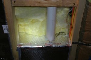

DWV in Return Air Ducts
Fluid dynamics is a complicated subject. Sometimes it comes down to which way the wind is blowing.
What's my opinion? or what code section would I use to deny that crap?

I assume this is a SFR and since the IRC is silent on this I will use the IPC and IMC.
2012 IPC
307.6 Piping materials exposed within plenums.
All piping materials exposed within plenums shall comply with the provisions of the International Mechanical Code.

3. This section shall not apply to materials exposed within plenums in one- and two-family dwellings.
"I assume this is a SFR and since the IRC is silent on this, I will use the IPC and IMC."
The IRC is intended to be an all encompassing bible for SFRs. Everything that one needs to build SFRs is in that book. The IRC covers ductwork/return air chases ("plenum") and DWV piping. The IRC does have not a prohibition of PVC piping in a plenum. Cherry picking regulations from other I-Codes to apply to an SFR is standing on shaky ground.

You missed the point of the code path that I outlined
It was to verify that since the IRC was silent on this installation and the mechanical code has an exception for materials in a plenum in a one and two family dwelling that the installation in the photo is not a violation of the IRC and therefore allowed.
Inspectors will sometimes call out things that just don't look right. As a building official I have to make the final determination if it is not specifically addressed in the code. Finding an answer in the IMC for a IRC building and basing my decision on another adopted code is not "shaking ground".
Seams are taped and the tape meets UL 181, nonmetallic insulated duct board meets a Class 1 rating, though I hardly see information on the duct material.
You have missed my point. Here's a simple example: The IPC requires a 3 inch drain when the fixture drain from an ACW combines with another drain. The IRC does not have that requirement. Should you apply the IPC requirement to the IRC building? No, because the IRC has everything you need to know about drainage piping for ACW standpipes and branch drain sizing. On the other hand, if someone installs a urinal in an IRC building, what do you do because the IRC doesn't cover urinals. That's when you go to the IPC for guidance on urinals.

Well, fortunately for me, WA state does not adopt the plumbing sections of the IRC, but adopts the UPC for both residential and commercial.
As for your point, I still disagree. The IRC is a conventional cookbook; if provisions for the desired system are not covered by the IRC, the code directs that the performance-based codes (IMC, IPC, etc.) be used.
R104.11 Alternative Materials, Design and Methods of Construction and Equipment
...Compliance with the specific performance-based provisions of the International Codes shall be an alternative to the specific requirements of this code. ...
M1301.1 Scope.
The provisions of this chapter shall govern the installation of mechanical systems not specifically covered in other chapters applicable to mechanical systems. Installations of mechanical appliances, equipment and systems not addressed by this code shall comply with the applicable provisions of the International Mechanical Code and the International Fuel Gas Code.

Even if you DO apply the IMC, PVC in plenums in SFR is still allowed^
