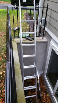

Good afternoon Everyone,
Ok here is the situation. Have a Realtor call, building inspector wont provide a c/o because the there is no gate to exit the window well.
Situation, there is a 46" deep window well, at the top of the masonry wall there is a 36" high guard around the opening, to prevent someone walking through the garden mulch from falling in to the window well. There is a ladder that goes from the bottom of the window well to the top of the guard.
Thus, when exiting through the window well you would climb up the ladder to the top of the guard, (38" above grade) swing over and drop down.
Now it's standard procedure by us to install gates to exit window wells like this when we do them, but after reading through the code I am trying to find out if the gate is a requirement?
How do you all see it or interpret the 2015 IRC EERO ladder exit requirement when it comes to a guard at the top of the wall opening?
Thank you - Tom

Ok, Let me start that I was never at this place before this afternoon, so what you are about to see was not of my doing, only what the client relayed over the phone.
They took an aluminum extension ladder, used 2 U bolts to clamp it to the top of the guard and then used 2 more U bolts to secure the rungs together so you could not slide the ladder between it's parts.
Here is your picture:
Not what I would have done, nor what we are going to be doing, but I will note that there are 2 windows in the bay and you could use one, but not the other.
In any case, with the ladder fixed in place and extending to the top of the guard, does this not meet the requirements and if not, how is the building inspector valid in requiring a gate.
Trying to stay on topic with my head still shaking from disbelief.
Thanks - Tom
Yikes! I think I would be compelled to accept stairs or a ladder that stops at the top of the wall. My thinking is if the widow sill can be 44 inches off the finished floor, why not the final step out of the well.

Lots of people would have a difficult time negotiating that setup. There should be a gate. I have never encountered a window well that is an EERO.

ICE, we always make them with the gate at the top, very common setup here, but the question becomes, as noted, is it required and is the current fixed in place ladder compliant per code requirements. Again not best case, but you get it? Window wells EERO's around here are very common.

top of ladder is higher than 30", provide steps or a ladder on the outside to take you back to grade.... or provide a gate in the fence. This is a egress component.

The 30" rule only applies if you have a "walking surface" immediately adjacent. A yard, or more specifically a flower bed (in this case), is not a "walking surface". As bad as that looks, it meets the requirements of the code.
The intent of the ladder requirement is to get someone out of the window well if they have to use the egress window. This setup, however fugly, lets you do that. If that house catches fire with you in the basement are you going to burn, or are you going to crawl up that ladder and fall off the guard to get away? I know which one I'd choose... Pass it and roll on to the next one.
And, why is the guard there anyway? Again - no walking surface adjacent, no need for a guard. If you're dumb enough to fall in that hole when working in the yard, the codes can't protect you from yourself anyway.
The guard may be required depending on how the AHJ defines a walking surface. We do not apply the term "walking surface" outside of a residence to the yards and other pervious surfaces.
If you have a guard you should have a gate or opening.
