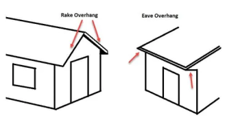

All the definitions I can find say a eave is a overhang:
In construction, eaves are the edges of a roof that extend past a building's walls, creating an overhang that protects the building from the elements. Eaves can serve both practical and aesthetic purposes.
2018 IRC requires frost footing if the eave is more than 10' high. If there are no eaves is there no height limit?
Is the "frost footing" required because there is more exposure to frost? What I mean is, when there is an eave, it provides some protection eliminating the need for the extra footing?
I'm asking because this has never come up in my climate....
The 2018 IRC does not define "eave."
I would define "eave" as a horizontal roof edge. Eaves may or may not overhang.
Google likes the Oxford Languages definition, which it claims is "the part of a roof that meets or overhangs the walls of a building." Again, no need to overhang.
I agree however it is not a "grey area" ;) There are specific code sections that refer to the eave or the rake of a roof. Therefore, a definition is not needed.
The eave is the lowest portion of the roof
[RB] MEAN ROOF HEIGHT. The average of the roof eave height and the height to the highest point on the roof surface, except that eave height shall be used for roof angle of less than or equal to 10 degrees (0.18 rad).
R804.3.2.1.1 Eave overhang.
Eave overhangs shall not exceed 24 inches (610 mm) measured horizontally.
R804.3.2.1.2 Rake overhangs.
Rake overhangs shall not exceed 12 inches (305 mm) measured horizontally. Outlookers at gable endwalls shall be installed in accordance with Figure R804.3.2.1.2.
R905.2.8.5 Drip edge.
A drip edge shall be provided at eaves and rake edges of shingle roofs. Adjacent segments of drip edge shall be overlapped not less than 2 inches (51 mm). Drip edges shall extend not less than 1/4 inch (6.4 mm) below the roof sheathing and extend up back onto the roof deck not less than 2 inches (51 mm). Drip edges shall be mechanically fastened to the roof deck at not more than 12 inches (305 mm) o.c. with fasteners as specified in Section R905.2.5. Underlayment shall be installed over the drip edge along eaves and under the drip edge along rake edges.
Locally, not globally; different eaves in different locations of the same roof may be at different heights.
Also, even that is not 100% unambiguous. If the roof edge has a slight slope, it's probably still an eave, but with enough slope, it becomes a rake. Where the transition occurs is not clear to me.
Furthermore, if the roof overhang varies along the length of a wall, the roof/wall intersection could be a level line, while the roof edge has a significant slope, like 2:12. Is that roof edge an eave (which would be true with a constant overhang) or a rake (since it is sloped)?

Here is a copy of the exception that I am talking about in section R403.1.4.1. Notice it also does not say where to measure from (floor, footing, sill plate, highest or lowest grade point?):
1. Protection of free-standing accessory structures
with an area of 600 square feet (56 m2) or
less, of light-frame construction, with an eave
height of 10 feet (3048 mm) or less shall not be
required.
I need exact points, from where to where?
The intention of this section is the theory that allowing a structure to heave with the frost could be ok as long as the building will not go far enough out of plumb that the structure would be damaged by it's own weight if the frost heaves higher on one side than the other.
They limit it to 600 square feet so that you won't have too drastic a difference between the frost heave and subsequent settling on one wall than the opposite, because the ground is more likely to be the same composition and temperature the closer together the walls are.
They limit the height to 10' to the eave because the taller you get, the more pronounced the lean would be and the more weight would be off kilter.
I recommend that you don't over-think this. I would measure to the top of the top plate, as that would be the "eave height" in 99% of all scenarios. If they don't like it, they can find someone else to approve it.
Especially since having a garage door unavoidably compromises the wall bracing to some extent, I would err on the side of being conservative.
From the point the bottom plate touches foundation. That is your effective wall height for resisting lateral loads. The foundation height above grade is irrelevant in my opinion.

There is a definition for eave height in the ASCE 7 -16 edition
EAVE HEIGHT, ft : The distance from the ground surface adjacent to the building to the roof eave line at a particular wall. If the height of the eave varies along the wall, the average height shall be used.
This correlates with wwhitney's post. Anything that extends past this definition is an overhang (eave or rake).

I ask the BCO of the township and he wasn't sure too. Finally, he decided that I should measure from the average level of the grade to the bottom of the lowest part of the overhang on the walls that support the rafters or if no overhang to the top of the top plate of the same walls.
I finally got an interpretation from the ICC:
We are concerned about the wall where the load from the roof rests. As a generic exception, this frost protection section limits the size of the building and the wall height to limit total load on the foundation. So the eave limit is the height of the wall, really the top plate at the eave. If the roof is a gable roof (typical), then the maximum wall height will be taller on the gable ends. So we look at the wall height at the eaves. The IRC in general has a limit of 10-ft wall heights. Even though the language used is ‘eave’, we are really concerned about the top plate maximum height.
Also, the IRC assumes that eaves extend only 2 ft horizontally beyond the wall, unless supported by posts/columns.

Do you measure from the top or the bottom of the eave (overhang)?
I got his email later from the ICC after I said I still don't know where to measure from to the eave.
Measure from top of concrete or masonry foundation to top of top plate of wall.
I agree – this exception has been siting in the code without being updated to current language. We need someone to submit a code change. Would you like to shepard a code change? Changes for the IRC are due at the beginning of January.
I also got a phone call from someone else from the ICC to measure from the grade. They did not say the lowest or highest point of the grade.
