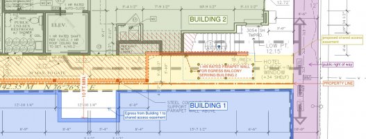

The exterior wall of Building 1 is located about 2ft off the property line. The neighboring building, Building 2, is approximately 6ft off the property line. There's approximately 8ft between the buildings. These two property owners plan to record a shared access easement on each other's properties, the entire width of the space between the two buildings. In other words, Building 1 has a ~6ft wide easement from the property line to exterior face of Building 2, and Building 2 has a ~2ft wide easement from the property line to exterior face of Building 1. Would Buildings 1 and 2 be allowed to egress into this shared access 'alley' between the two buildings?
I don't think this is relevant, but there is an 'egress balcony' along this alley that serves the second floor of Building 2. It doesn't interfere with the egress width, aside from a handful of columns near the property line. So the egress balcony creates an 8ft ceiling for the proposed egress path from Building 1, along the alley, and out to the public right of way.

Hey @mtlogcabin, thanks for the reply. The egress balcony on the neighboring building (Building 2) was the solution the AHJ offered. It has a 1-hr rated wall/parapet extending 30in above the roofline of Building 1. The permit has already been approved for Building 2, with the egress balcony as I have described. I've included a little exhibit here. @classicT, we would jog the exterior wall back to a minimum 10ft, see exhibit.
However, I don't think the egress balcony would have any impact on the question at hand, right? Which is: can Building 1 egress across a neighboring property, provided they have a legally recorded shared access easement on said neighboring property? Assuming of course that all other provisions of Chapter 10 are satisfied.

Awesome, that was my understanding as well. I suppose having a recorded access easement doesn't necessarily do anything to define the fire separation distance though, correct? Per the CBC definition, the fire separation distance is measured from ONE of the following:
  • The closest interior lot line.
  • To the centerline of a street, an alley or public way.
  • To an imaginary line between two buildings on the lot.
By recording a legal access easement between the properties, wouldn't we be creating an alley? The Code doesn't seem to speak to how to determine which of those three distances to choose.
No not IMHO if it is privately owned. Your local codes (zoning, public works) may have a definition of alley that is different from what I found in the I-Codes
If it meets the definition of Public Way then it may be referred to an alley otherwise it is just an access easement
[A] PUBLIC WAY. A street, alley or other parcel of land open to the outside air leading to a street, that has been deeded, dedicated or otherwise permanently appropriated to the public for public use and which has a clear width and height of not less than 10 feet (3048 mm).
ALLEY. Any public way or thoroughfare more than 10 feet (3048 mm), but less than 16 feet (4877 mm), in width, which has been dedicated to the public for public use.
@mtlogcabin Yes, thanks for the reminder. I did look up the Chapter 2 definition of alley at one point, and saw the 'public use' language. So in short, I'm still able to egress into this shared access easement area for a required exit, but the FSD line stays on the property line. I'll post a 'part two' to all this, because there's a more complicated question I have to answer. But wanted to establish this first. Thanks for the help!
