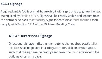

Are you referring to this? (“Readily seen” = another subjective interpretation!)
No. I'm referring to the tendency of banks (and CVS pharmacies) to hide the only toilet rooms behind locked doors in order to make them inaccessible to patrons. I have lost count of how many banks I have had this argument with.
Often, the route to the toilet room(s) is behind the teller counter, and (naturally) customers are not allowed behind the teller counter. When I point out that the toilet room(s) is/are required to be available to patrons, the response is "But we can't allow customers behind the teller counter."
And then I ask, "The why did your architect put the toilet room(s) behind the teller counter?"
The answer, of course, (which they won't admit to) is that it's because the bank told the architect to put the toilet room(s) back there, because they don't want customers to use their toilet rooms.
Sometimes they try to argue that a bank falls under Exception #2, for quick transactions. Then I ask if their branches let customers open new accounts, apply for mortgages, and if they offer brokerage consulting services. Of course they do -- and none of that falls within the quick pick-up and drop-off exception.
