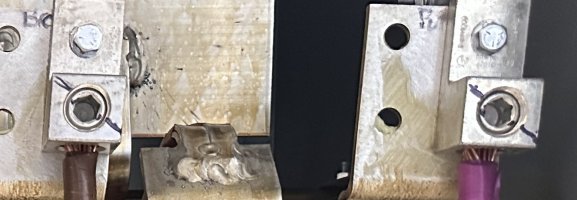

You almost got witness marks... and what about the lug mounting hardware? Did the lugs come factory installed? If it was factory I'm pretty sure that they would fill the hole and that would be a different lug.
Not sure what that round thing is attached to the meter pan. It's just a service inspection and I'm not suppose to look past the service disconnect and the grounding, but I have to look at the new panel too. But I can't say anything about the existing conduits and wiring below the new panel but I can make them get approved connectors for panel to well pipe.
"I'm not suppose to look past the service disconnect and the grounding"
I couldn't do that.
Better pictures would help. Not able to figure out what's at the top.
