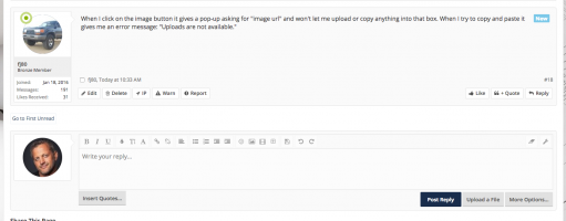

When I click on the image button it gives a pop-up asking for "image url" and won't let me upload or copy anything into that box. When I try to copy and paste it gives me an error message: "Uploads are not available."

See photo below. Upload file, it's right there on the bottom right.
