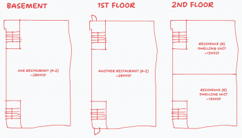

Elevator? 2 stories and a basement - A-2's and R-2.
Ryan Schultz
Apr 2, 2012
283
Madison, WI
Does the following scenario require an elevator to the basement?
I assume it does not, under the following logic.
Per 1107.6.1.2, since there’s less than 3 dwelling units on the 2nd floor, the 2nd floor is not an accessible story.
Per 1104.4, since the basement area is less than 3000sf, it does not need to be accessible.
This is a Type VB, unsprinklered.

Is there's only (2) residences, per 1107.6.1.2, the 2nd floor is not considered an 'accessible story', so it's square footage would not be included in the 'aggregate' calculation, correct?

What is the existing condition? The building? The use groups in the building?

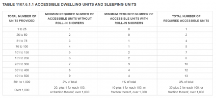

You mentioned 1107.6.1.2, which is in Group R-1 [hotels, motels, boarding houses (more than 10 occupants) and congregate living facilities (more than 10 occupants) where the occupants are primarily transient in nature.] Table 1107.6.1.1 requires 1 Accessible unit when the total number of units provided is 1 - 25.
