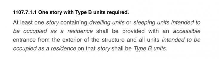

1107.7.1.1 requires an accessible entrance and Type B units on at least one story containing dwelling units. The accessible route doesn‘t specifically require an elevator, but that’s the most likely solution to providing an accessible route to the story above the commercial space.

The Fair Housing Act would apply to this project given the info you provided. Since there are no residences on the "first floor", the second floor (where the apartments are) would be considered the "ground floor" for accessibility reasons and must be on an accessible path.
You don't necessarily need an elevator, but you need an accessible route to the units.
True - if it was possible, technically, it could be accomplished w/ a ramp even though that would be a horrible use of space.
