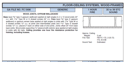

Do you know a UL assembly for the underside of the stair, or can i just spray it with intumescent paint?
If you have 2 by stringers you can use Gypsum Association FC 5406. It requires 2 layers of 5/8" Type X gypsum board, and the ceiling provides 1 hour protection for the joists. FC 5407 & FC 5408 are the same, except for I-joists or trusses.
Those numbers are not in GA 600-2021 (I don't have the 2024), but FC 5529 appears to be a similar generic assembly for 2x framing. Of course the building code will determine the applicable edition.
Interesting. FC-5406 was in the 2003 edition, and it had a bold-faced note that the 2 layers of GWB provided 1-hour protection for the joists.
