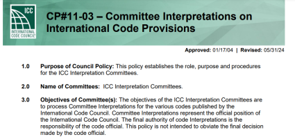

Are such ICC interpretations binding upon jurisdictions that adopt the IRC?
My state doesn't adopt the straight ICC codes, we adopt them with state amendments. We have a state statute that says only the State Building Inspector is authorized to interpret the code. So, in this state, ICC interpretations are guidance only, not binding, even if the code section was not revised by an amendment when we adopted it.
NO read Number 3.
The final authority for code interpretations is the Code Official
Committee Interpretations approved by the ICC Interpretation Committee represent the official position of the International Code Council; however, the final authority of code interpretations is the responsibility of the code official.
