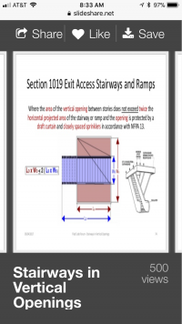

First time posting, but I'm working on a similar project as nealderidder, where I'm trying to get an open stairway under the provisions of 1019.3 Condition 4. However, one of those four floors is a basement (and one of them is a roof). Can you point me to the code section that precludes the basement connection?
If the basement can't be connected through the same vertical opening, can the stair to the basement just be relocated elsewhere in the building? If so, how far away would it need to be relocated in order to not constitute a vertical opening?
The reason I mentioned that it could not include a basement was because the building that the OP mentioned was a 4-story building, and Section 1019.3, subparagraph 4, limits this condition to four stories. Therefore, I stated that unenclosed stairs connecting all four stories is permitted as long as there is no basement involved. Basements are permitted to be connected using exit access stairways, but they are counted as one of the connected floors.
Oh I see! Well that’s great news. So provided I meet all the criteria of Condition 4, I could have a rooftop access, two floors and a basement all atmospherically connected by an open stair? Awesome.
Now can you help me understand the part of that Condition 4 which states “...the area of the vertical opening between stories does not exceed twice the horizontal projected area of the stairway”? Is There a diagram or something you could direct me to that explains what that means? Thanks so much for your help, you appear to be a legend on these forums and I greatly appreciate your expertise and online resources!

Just be careful. If your opening gets too large it could be considered an atrium, and a smoke evacuation system would be required if more than 2 stories are connected without enclosures.
Nevermind, I was able to find the same slide on image search: https://image.slidesharecdn.com/201...in-vertical-openings-77-638.jpg?cb=1498829212
I'm complying with that so I think we're all good, thanks for all the help everyone!
