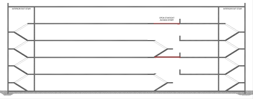

I'm working on a presentation regarding Exit Access Stairs (EAS) and need your help to make sure I've got the details right. Ron G. has been trying to explain this to me for ten years now so this might take some work. I'm looking to create a definitive explanation of what's allowed/required/possible (and will share it). Thank you in advance for your help!
To get started - let's say I've got a 5-story office building (B) that requires two exits off each level which are provided by two properly separated Interior Exit Stairs (see attached diagrammatic section). I want to add an additional open stairway that connects all 5 stories. This stairway is not required for egress. Some questions about this hypothetical open stair:
1. Is it an EAS? CBC 1019.1 defines EAS as exit access stairways serving as an exit access component in a means of egress system... Is there a legit argument that the open stair is not a part of my egress system and thus not an EAS and thus section 1019 doesn't apply?
2. Related to #1 - Is it even possible to have this open stair if it is NOT an EAS? CBC 712 seems to imply that if I want this open stair it needs to be either:
  • In an atrium (then it's not an open stair)
  • Not connecting more than two stories and not thru a rated floor assembly (I'm doing both)
  • An Exit Access Stair
It seems to me that if I want an open stair connecting more than two stories, that's not in an atrium, I can only do it with an EAS. And if it's an EAS it would then have to meet the requirements of 1019 regardless of whether or not I need it for my egress system. Sound correct so far?

712.1.9 is specifically for two-story openings that are "not used as one of the applications specified in this section" What I'm talking about is one of the applications specified in this section, that section being CBC 712.1.12 Exit access stairways and ramps. And I'm talking about more than a two story opening so I don't think this section would apply to the condition posed.

1. Is it an EAS? YES CBC 1019.1 defines EAS as exit access stairways serving as an exit access component in a means of egress system... Is there a legit argument that the open stair is not a part of my egress system and thus not an EAS and thus section 1019 doesn't apply? NO
2. Related to #1 - Is it even possible to have this open stair if it is NOT an EAS? IT CAN ONLY BE AN EAS CBC 712 seems to imply that if I want this open stair it needs to be either:
  • An Exit Access Stair YES
It seems to me that if I want an open stair connecting more than two stories, that's not in an atrium, I can only do it with an EAS YES. And if it's an EAS it would then have to meet the requirements of 1019 regardless of whether or not I need it for my egress system. Sound correct so far? YES

Neal, in regards to your OP question #2:
That open stair cannot atmospherically interconnect all 5 stories as per your original sketch:
You could atmospherically interconnect any two floors, such as floors 1+2 and floors 3+4, like this:

Yikes - I'm glad you weighed in, this is exactly the response I've gotten that I can't square with the code. I've done an AMMR and surrounded the opening with Won-Door and everyone seemed satisfied. But help me find the code provision that says I can't atmospherically connect all 5 stories in this situation. I've attached that building section again along with a plan view.

Commish - appreciate your point but this is a hypothetical exercise. As I stated in the original post I'm trying to reach a conclusion on what's possible. When it comes to legal language I think in depth analysis is unavoidable. I'm not looking for the most conservative answer that wouldn't raise eyebrows anywhere. The idea that code will only allow two stories to be connected directly conflicts with the language in 1019 - In other than B and M occupancies, this provision is limited to openings that do not connect more than four stories - I do feel like I'm chasing my tail and wish 1006.3 (CBC) was clarified a bit...
Theoretically then:
You can have a vertical opening for any two stories, with or without stairs.
You can have a vertical opening for stairs up to four stories with size limitation, sprinklers, and draft stops.
Not codified as such but probably you could go at least four, maybe more, if enclosed in a "shaft" composed of opening protectives, theoretically, if you can afford it.
I don't think the fact they are exit access stairs, required or not required, is a factor.
