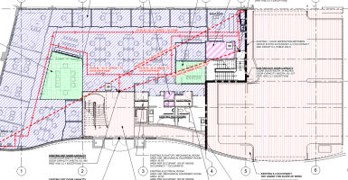

Reviving this with a twist.
This is an existing building, proposing an interior remodel without changes to the exiting. From what I can tell, the second exit from the space goes through the exit enclosure at the stairs, then out to the parking garage, then back into the building across the fire separation and then out the main exit. I can't seem to find any other exit discharge locations. The parking garage vehicle access openings are enclosed by roll up security grills. Can't figure out how this was approved. I can see how the exit discharge through the garage may have been permitted, but not with the gates. Maybe the gates were added later, and either missed or unpermitted? Am I missing something?
Sorry, should have included that this is a two-story multi-tenant building. 1/2 the main floor as S-2, the entire second floor is B. Apears to be ok as separated mixed use and assume it is fully sprinklered. Also, would this not exceed the 50% limitation for exit discharge to other than the exterior (2018 IBC 1028)? So even if a side hinged door was installed in the garage, it is questionable.
This brings up a debate I have faced many times and I am still conflicted by. If this existing building is not compliant, and never was (19 years old), yet the alterations do not included these issues, does the IEBC excuse it? Both prescriptive and work area methods specify that the alterations must comply, not the unaltered portions.
