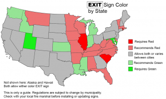

We have had this conversation before but did you know the color of the Exit Signs can vary depending on the state or municipality?
In the US, exit signs can have either red or green lettering, but traditionally have been red. Many states and many municipalities have modified the Building/Fire codes which specify the sign color.
Though testing... Green fluorescent signs can be seen better in dark conditions than other colors, as the human rod cell is more sensitive to these wavelengths.
An would you, in a smoke filled room, run toward a red glow or a green glow?
In Europe they are required to be green.
We have had this conversation before but did you know the color of the Exit Signs can vary depending on the state or municipality? In the US, exit signs can have either red or green lettering, but traditionally have been red. Many states and many municipalities have modified
the Building/Fire codes which specify the sign color. Though testing... Green fluorescent signs can be seen
And would you, in a smoke filled room, run toward a red glow or a green glow? In Europe they
Canada is the green running man symbol, same as Europe.

This being the case, what is the best color, "it" depends.
Interesting chart, never seen that before. I would guess, to solve the problem, you need contrast. Like a black or white background.
