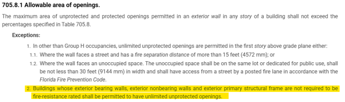

RLGA - Looking at this from Yankee Chronicler's viewpoint that the existing building has 100% unprotected openings, and your comment that "The location of the imaginary line cannot make an existing building non-compliant", wouldn't it be correct that based on Table 705.8 for Unprotected, NonSprinklered nothing can be built within 30' of the existing building (unless some walls were added at the existing building)?
No. Refer to Section 705.8.1, Exception 2.
At 10 feet, exterior nonbearing walls are not required to be fire-resistance-rated. With Type VB construction, exterior bearing walls and structural frame are not required to be fire-resistance rated. Thus, you are permitted to have unlimited unprotected openings at 10 feet.
And, as the designer, you get to draw that "imaginary property line" anywhere you want. If the proposed new building has exterior walls with the required fore-resistance rating and no openings, the line can be the exterior face of the new building.
Just remember that, once you draw it and submit it and it gets approved, it becomes part of the building (and site) record. Any future changes -- such as punching windows and doors into those walls -- will have to deal with the position of that line (unless you submit a new permit application to revise its location).
Thank you very much for that info!

Correct, and exterior unprotected openings would be limited to 10% of the exterior wall if nonsprinklered and 25% if sprinklered.
No, Table 705.5 does.
If the fire separation distance is less than 10 feet, per Table 705.5, a 1-hour exterior wall is required; thus, Exception 2 to Section 705.8.1 would no longer be applicable. Since Exception 2 does not state "per Table 601," the fire-resistance rating condition applies regardless of what provision requires those elements to be fire-resistance rated.
